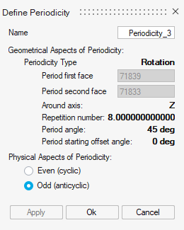

Dialog Box
The minimum information to be entered is:
  • Geometrical Aspects: select two faces is mandatory to define the planes of periodicity.
    • Periodicity type
      Note: Only "Rotation" available in current release
    • Period first face: the reference plane
    • Period second face: the final plane
      Note:
      • The order of the starting face/ending face is not important. (we take the portion which contains the represented device)
      • It's mandatory to have identical geometry and mesh between these two planes. Please use the Symmetry Mesh mesh control
      • The periodicity axis defined by the intersection of the planes must be one of the predefined axis: X or Y or Z.
    • "Read only" information (automatically identified after the selection of both planes faces):
      • Around axis: common axis
      • Repetition number: number of part to complete the full device
      • Period Angle: angle between the two planes
      • Period starting offset angle: angle between the reference plane and ZX plane if Z axis, XY plane if X axis, YZ plane if Y axis.
      Note: This "read only" information is updated if the device is moved.

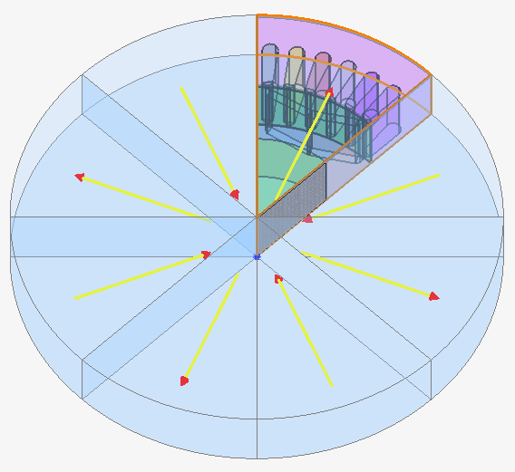

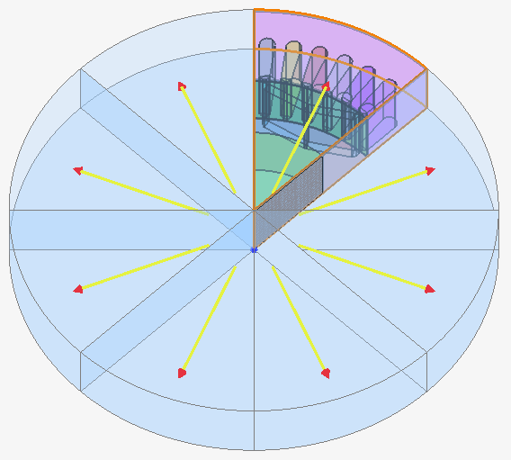

    The preview shows a simple illustration of the magnetic field direction in each portion depending on the chosen option, as you can see in the following image.
    Even (cyclic) Odd (anticyclic)
