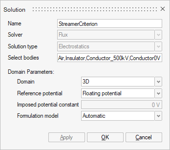

  1. Double-click on the Solution button in the Solution Browser:

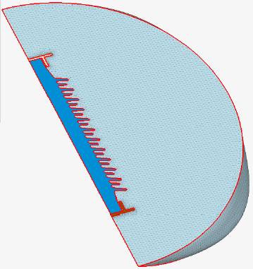

  2. Select all the meshed bodies:
    The outlines of all the bodies are displayed in red.
  3. Click on the OK button
    All the bodies are now assigned to the solution.
