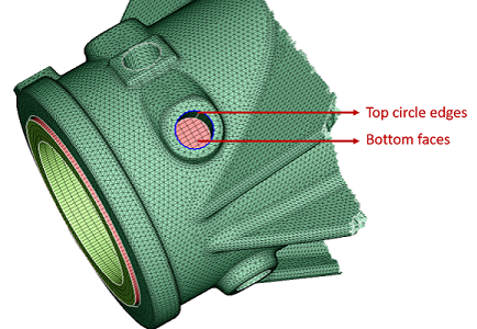

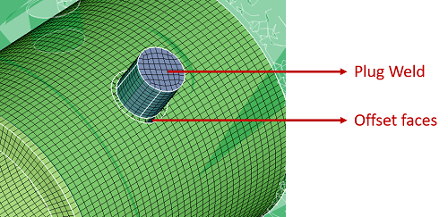

This tool is used to create cylindrical plug between two tube shaped parts without connection.
- Top Circle Edges: User can select tube's top outer circular edges.
- Bottom Faces: User can select the faces on which plug is going to be connected.
- Axial Number of Layers: Number of element layers required in plug's axial direction.
- Create Boundary Offset at Bottom Edges: This will create boundary offset faces for the given offset distance with required element layers.

Input
Output
