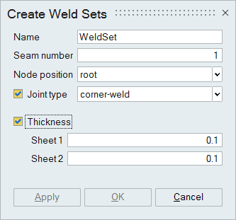

Create Weld Sets
Advanced > Weld > Femfat Sets
Dialog Box
This tool is used to create a node set using the edges / nodes selected. For FemFat Solver, It frames the set name using on the parameters defined in this dialog.

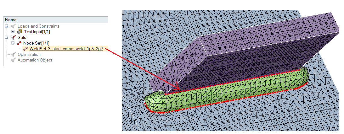

Example
After import FemFat file
