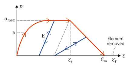

ε p m a x Failure plastic strain. 11
Default = 1020 (Real)
ε t Tensile failure strain at which stress starts to reduce. 2
ε m Maximum tensile failure strain at which the stress in element is set to zero. 2
Default = 2.0 x 1020 (Real)

ε f Tensile strain for element deletion. 2
Default = 3.0 x 1020 (Real)
