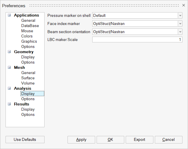

Display
File > Preferences > Analysis > Display
Pressure marker on shell
Use this option to set the pressure marker based on SimLab default or Nastran.
Face index marker
This option is used to set the solver type to view the solver specific face index for solid elements, using View | Labels | Nodes & Elements.
Beam section orientation
This option is used to display the beam section orientation based on selected solver type.
LBC marker Scale
This is used to vary the load marker. At present only pressure,force,constraints and co-ordinates markers can be changed using marker settings. By default Scale value is "1". Changing the Scale value gives the difference in load markers.
