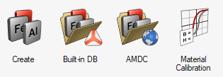

The Material has secondary ribbon, which consists of the following tools:
For Magnetostatic (2D, 3D and Integral), AC Magnetic (2D and 3D) and Transient Magnetic (2D and 3D) solutions, the Material Calibration tool is also available:

In order to create materials, In the Analysis ribbon click on click on Material and click on Create .

Open the Material Database manager
In order to open the material database manager, click on the Built-in DB
It allows to open:
  • the SimLab Material Database
    You can import materials from the predefined SimLab Material Database into the SimLab project using the Load to Material Browser button.
    This database contains many materials of electric, hard magnetic and soft magnetic types.
  • a User Material Database if you have already created one
    You can import materials from a User Material Database into the SimLab project using the Load to Material Browser button.
    You can modify the material properties using the Update Database button.
Open the AMDC Material Database manager
In order to open the Altair Material Data Center (AMDC), click on the AMDC
