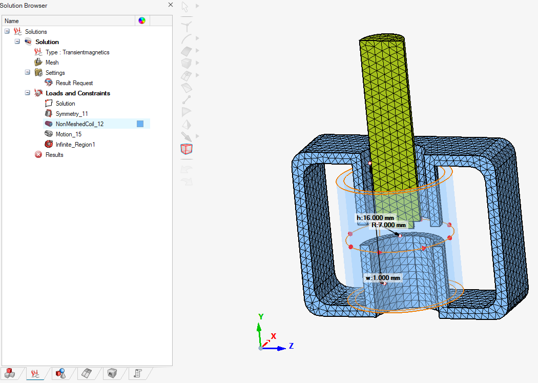

    Here is an example of Circular Non-Meshed Coil with rectangular section on a linear actuator:

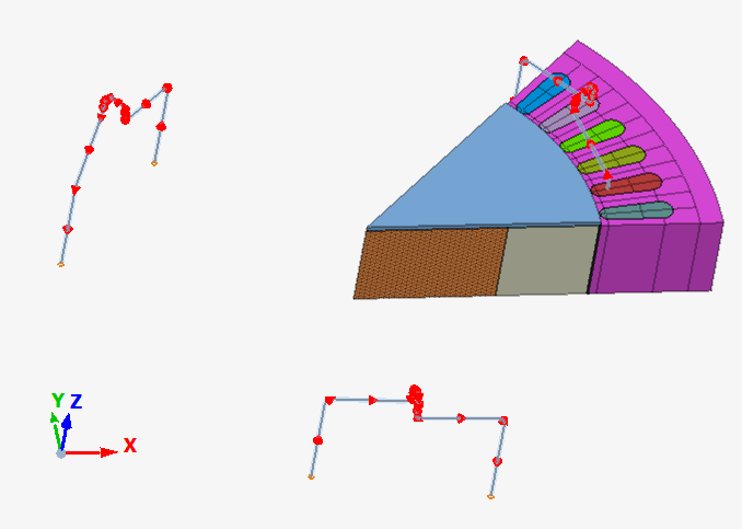

  • Composed coils: Composed coils are ones which complex shape is defined by the user. The section is circular or rectangular.
    The shape of the coil is the path (open or closed) composed by a set of points. The connecting elements between the points are built on the basis of straight segments with taking into account of the curves if they exist.
    Composed coil with circular section Composed coil with rectangular section
    Here is an example of composed Non-Meshed Coil with circular section:

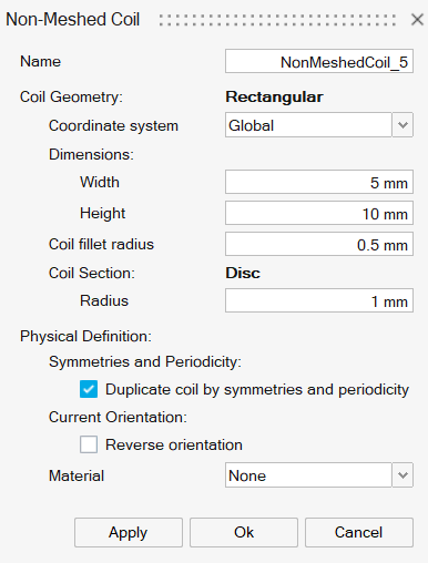

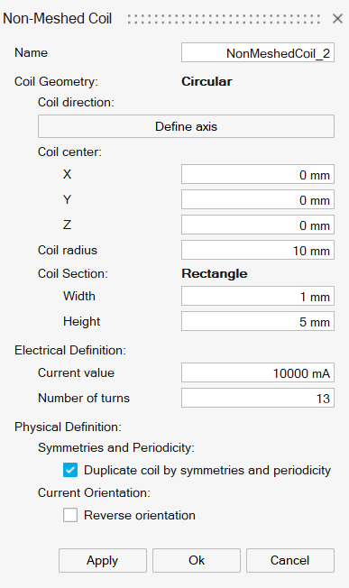

Predefined shape Non-Meshed Coils dialog box for MS3D and MSIM solutions
Predefined shape Non-Meshed Coils are defined by two coil path shapes: circular or rectangular and two section shapes: disc or rectangular.
Here are two dialog boxes to get an overview of all the possible inputs:
  • For MS3D solutions:
    Circular coil with rectangular section
    Rectangular coil with disc section
  • For MSIM solutions:
Each Non-Meshed Coil is defined by geometrical and physical inputs.
The direction and position of the predefined shape Non-Meshed Coil are defined differently for rectangular and circular shape:
  • For circular shape coil:
    • Define axis: definition of the coil axis direction. The axis is picked graphically.
    • Coil center: definition of the coil center by entering its coordinates values in the global coordinate system.
  • For rectangular shape coil:
    • Coordinate system: Selection of the coordinate system. The Z axis of the coordinate system defines the coil axis. The coil is centered on the coordinate system center.
      By default, Global coordinate system is taken.
      Note: If the Global coordinate system is not suitable, a new local coordinate system must be created. For more details on coordinate system creation and modification, please refer to the section How to create and modify a coordinate system above.
Once the coil orientation and position is defined, the coil path line inputs are entered:
  • For circular shape coil: Enter the Coil radius value defined by the distance between the coil center point and the coil path line.
    • Enter the coil Height and Width values defined by the distance between two outermost points of the coil path line, on both directions. The height corresponds to coordinate system Y axis direction, the width to X axis direction.
    • Enter the Coil fillet radius value to create a fillet on each coil corner.
Circular coil (rectangular section) Rectangular coil (disc section)
After the coil path line definition, the coil section is defined:
  • Disk section is defined by Coil section radius value
  • Rectangular section is defined by Coil section height and Coil section width . The height corresponds to coil axis direction and the width to the other direction.
Circular section Rectangular section
Note: On the non-meshed coil preview, the dimensions are displayed to help the geometrical definition.
Once the geometrical definition done, the physical inputs are entered:
  • Current value:
    The value of current flowing in the coil
  • Number of turns:
    The number of turns of the coil
  • For MS3D solutions, Symmetries and periodicity:
    • Duplicate coil by symmetries and periodicity:
      Choice to duplicate or not the coils with respects to the symmetries and / or periodicity.
      By default, the duplication is enabled which is the most common configuration.
    • Connection type:
      is used if the duplication with respect to symmetries / periodicity is enabled. This input allows to define the symmetric or periodic coils as in Series or in Parallel or with the Number of coils in parallel.
    Note: For more details, please look at the section Symmetry and periodicity with Non-Meshed Coil below.
  • Coil current orientation / Reverse orientation:
    By default a current orientation is proposed (please see the preview). It is possible to reverse it.
When clicking on Ok, the Non-Meshed Coil load and constraint entity is created in the solution Loads and Constraints data tree.

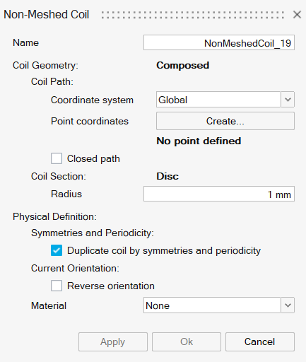

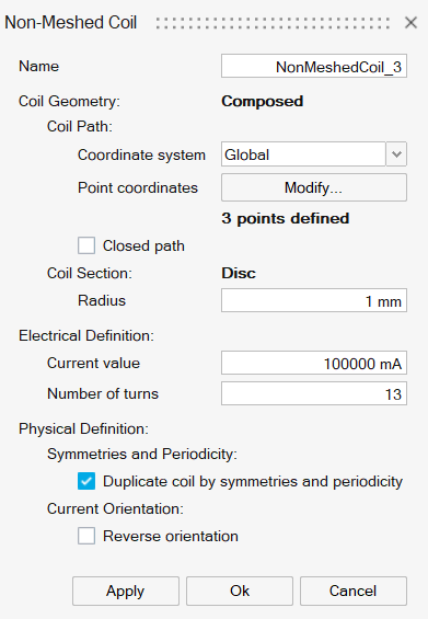

Composed Non-Meshed Coil dialog box for MS3D and MSIM solutions
The composed Non-Meshed Coil is a free shape Non-Meshed Coil defined with points coordinates. The section is defined in the same way of the predefined shape Non-Meshed Coils.
Here is the dialog box of the composed coil with disc section:
Here are the inputs for composed coils:
  • Coordinate system: Selection of the coordinate system where the points coordinates are defined. By default, Global coordinate system is taken.
  • Points coordinates > Create... opens a second box called Define Points to enter the points coordinates defining the coil path line. The curvature radius (fillet radius) is also entered for each point (0 if no curvature). Here are some images to explain the curvature radius:
    Composed coil with closed path, described by 3 points Composed coil with open path, described by 3 points
    a curvature radius R = 0
    a curvature radius R <> 0*
    is associated to the point P 2
    Note: * The value of a curvature radius R in a specified point must be between 0 and the minimum of the distances (the distance between this point and the point which precedes it and the distance between this point and the point which follows it).
    It is possible to enter manually the values or import a .csv or .txt or .dat file containing all the data through Import... button. The file should contain the data in the following format: 4 columns (for the coordinates values in X, Y and Z directions of the selected coordinate system and the curvature radius value). The columns can be separated by one of the following separators: semicolon ';', comma ',', space ' ' and tabulation '\t'.
    Note: To define the point coordinate file that represents the coil path of the windings, use the Create Mid Wire and Export Coil Points tools. These tools will help to accurately map out and export the coil's winding path coordinates.
    In the Define Points dialog box, it is possible to manage each line of the data. The tools are available in a contextual menu, when right-clicking on the line number. User can:
    • Insert a new empty line before the selected line
    • Delete the selected line
    • Up the selected line above the previous line
    • Down the selected line below the following line
    While entering the points coordinates and curvature radius values, several checks are done instantaneously to verify that the Non-Meshed Coil geometry is correctly defined. The error messages appear as soon as an error is detected on the Point status part.
    Note: Some errors are not catched on the Point status (not detectable or not implemented yet). User has to pay attention by checking visually the coil preview.
  • Closed path checkbox: Choice of closing or opening the coil between the first and last points, depending on its representation with respect to symmetries and/or periodicity: The coil must be opened if the two points are on a symmetry or periodicity plane. Otherwise the coil must be closed.
  • Coil section:
    • For disk section, Coil section radius is entered
    • For rectangular section, Coil section height, Coil section width are entered. The rectangular section orientation in the section plane is defined automatically from the coil path points. More precisely, the direction change from a segment to another must be done around one of the two directions of the coil section. The first axis of direction change is taken for Height or Width. Please check the preview to identify them.
  • Current value:
  • Number of turns:
    • Connection type:
Composed Non-Meshed Coil dialog box for MT3D and MAC3D solutions
In MT3D and MAC3D, the physical inputs are mainly defined in the circuit designer coil component. The Non-Meshed Coil dialog box contains mainly geometrical inputs.
  • Coil section:
Note: On the non-meshed coil preview, the dimensions and the point id are displayed to help the geometrical definition.
  • Symmetries and periodicity / Duplicate coil by symmetries and periodicity:
    Please refer to the section Symmetry and periodicity with Non-Meshed Coil below.
  • Material is an optional field to select a material with a resistivity value in order to compute the Joule losses. If a material with resistivity value is selected, Coil fill factor value in ]0,1] must be entered in the associated circuit coil component.

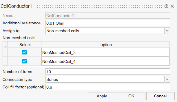

Coil physics in the circuit designer (MT3D and MAC3D)
In MT3D and MAC3D, the physical inputs of a Non-Meshed Coil must be defined in the circuit designer coil conductor component.
Here is the dialog box of the coil conductor component:
The inputs of the coil conductor dialog box for Non-Meshed Coil are:
  • Additional resistance: Additional resistance of the coil can be added
  • Assign to > Non-Meshed Coils
  • Number of turns: defines the number of turns of the coil
  • Connection type: is used if the duplication with respect to symmetries / periodicity is enabled in the Non-Meshed Coil dialog box. This input allows to define the symmetric or periodic coils as in Series or in Parallel or with the Number of coils in parallel. For more details, please look at the section Symmetry and periodicity with Non-Meshed Coil below
  • Coil fill Factor (optional): defines the optional coil fill factor value. The value must be in ]0,1]. If the coil fill factor value is entered, the coil Joule losses will be computed. For that, a Material with a resistivity value must be assigned on the Non-Meshed Coil dialog box.
In case of symmetric and/or periodic device (symmetries / periodicity entities are created), the user has the option to duplicate or not the represented coil:
By default, as it represents most of cases, the option Duplicate coil by symmetries and periodicity is checked.
In some specific cases, the user may not want to duplicate the represented coil. Here are two usecases:
  • Creation of a composed Non-Meshed Coil by importing a file defining the path of the complete coil.
  • Simulation of a device with two parts: one part partially represented because of symmetries / periodicity, and another part containing a complete coil which does not need any duplication (example: wheel speed sensor).
Once the duplication selected, the Connection type have to be defined. The connection type defines how the represented coil and all the symmetric/periodic coils are connected.

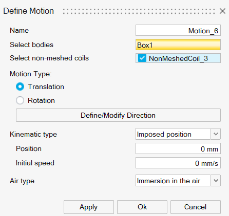

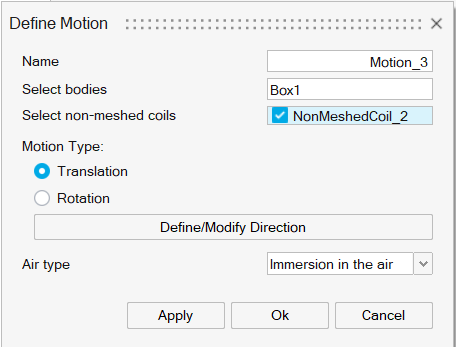

Motion
In a device, bodies can move but also Non-Meshed Coils can move.

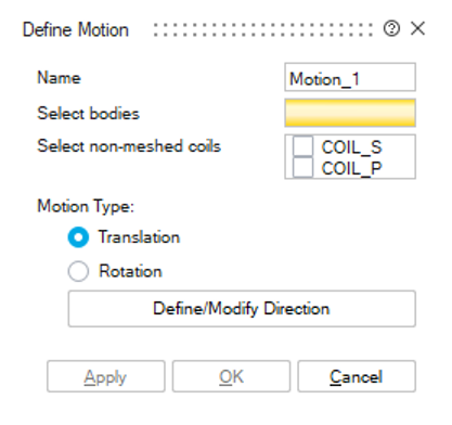

User can define the motion for both bodies and Non-Meshed Coils in the Motion load and constraint:
  • In MS3D and MAC3D:
    The moving Non-Meshed Coils are checked as in this example.
  • In MSIM:
  • In MT3D:
For more details on Motion load and constraint, please read Motion.

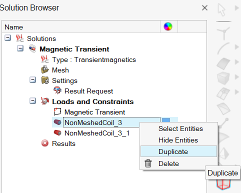

How to duplicate a Non-Meshed Coil
The Non-Meshed Coil duplication can be really helpful to earn coil definition time, especially for composed coil.
The duplication is available on the right-click on a Non-Meshed Coil entity through Duplicate button:
When clicking on Duplicate, a new Non-Meshed Coil entity is created with a name corresponding to the initial Non-Meshed Coil name with "_IDNumber" ("_1" or "_2" or etc.).
The common workflow with the duplication is to:
  • Create a Non-Meshed Coil
  • Duplicate it
  • Edit the duplicated Non-Meshed Coil to modify the coordinate system for composed coils and rectangular coils or the center coordinates for circular coils

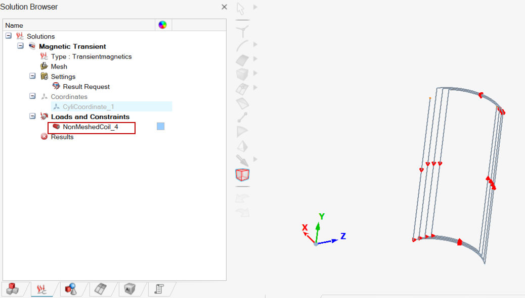

  • The Non-Meshed Coil preview needs to be improved:
    • No representation of the duplicated parts of the coils with respects to symmetries and periodicity
    • No dimensions display on the graphic to help the geometrical inputs entering
    • No visualization of the Non-Meshed Coil preview in the post processing except while the dialog box is opened.
