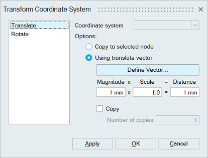

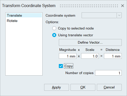

- Translate
Coordinate system can be moved/copied to a new position.
- Using translate vector
This option is used to move / copy the selected coordinate system by specifying direction and magnitude of translation.
- Copy to selected node
This option is used to copy the selected coordinate system to the specified node location. The new coordinates will have the same orientation as the selected coordinate.

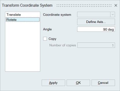

- Rotate
Coordinate system can be rotated about an axis using the specified angle of rotation.
