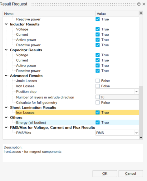

  • For 2D and 3D AC Magnetic solutions, in Result Request, in Sheet Lamination Results node, you should choose True for Iron Losses computation.

  7. To compute the iron losses in Transient and AC analysis: before solving, edit Result Request and define the Sheet Lamination Results
    1. Choose True for the Iron Losses
    2. For 2D and 3D Transient Magnetic solutions, define the interval: Min Computation Step and Max Computation Step
    3. Validate by clicking on OK
