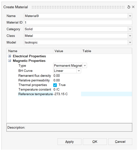

Create Materials
In order to create materials, In the Analysis ribbon click on click on Material and click on Create .
It opens the Create Material dialog box:
You can create 2 different types of magnetic materials:
  • either Hard Magnetic in MS 2D and 3D and MT 2D and 3D (but not in MAC 2D and 3D):

Steps for creating materials
  1. Click on the Create
  2. Enter a name for the material.
  3. You can keep the default values in the 4 following fields:
    • Material ID
    • Category: Solid
    • Class: Metal
    • Model: Isotropic
    Note: This information has no impact on the electromagnetic simulation.
  4. Define magnetic properties: Magnetic Properties.
    Note: In MS 2D and 3D, you can add other properties (thermal, electrical, ...) but they will not be taken into account for the simulation.
  5. Enter the characteristics of the material.
  6. Click on the OK button.
    The material is created.
    You can see it in the Property Browser (5th tab).
