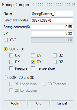

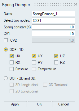

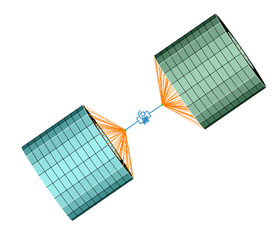

Spring Damper
This tool is used to define Spring Damper element between two nodes.
Example
