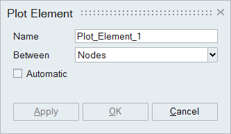

Plot Element
This tool is used to create Plot element between two nodes by selecting two nodes/edges/faces.
- Automatic
Turn ON this toggle to proceed the process automatically after picking the entity.
Cards supported for various solvers
