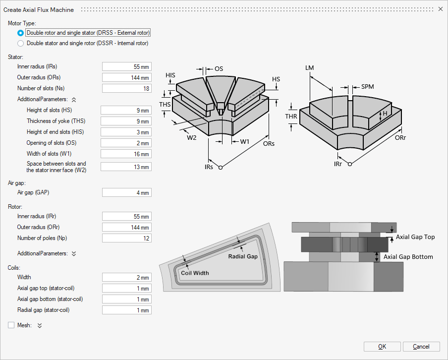

Dialog Box
The dialog box contains several field and parameters to configure:

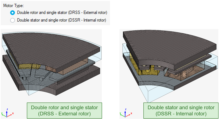

- Motor type
Two different motor configurations, the DRSS (external rotor) and the DSSR (internal rotor) are available, as shown below:

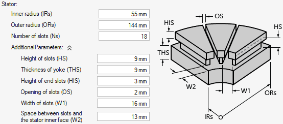

- Stator modeling
There are a total of nine geometric parameters (some detailed parameters are hidden in the Additional Parameters drop-down menu) to control the modeling of the stator, as shown below:

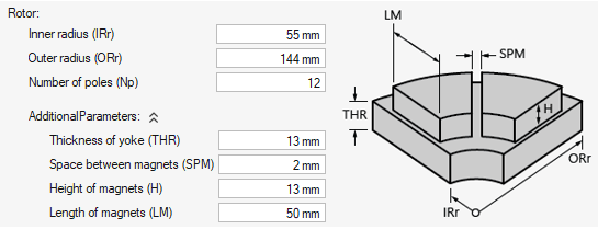

- Rotor modeling
Similar to the stator modeling, there are a total of seven geometric parameters (some detailed parameters are hidden in the Additional Parameters drop-down menu) to control the modeling of the rotor, as shown below:

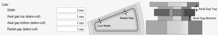

- Coils modeling
Establishing geometric models of windings can help to use mesh coil in the following electromagnetic analysis to enhance the result accuracy. As shown below, the coil size is controlled by the parameter WIDTH, and the position of the coil is controlled by other parameters.

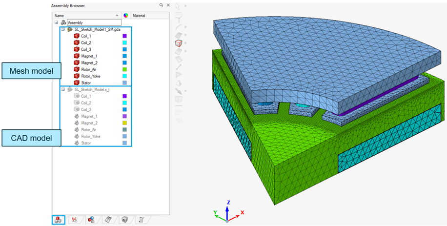

When all parameters are set, click on OK to generate the motor model.
→ The generated motor model (both the mesh model and the CAD model) can be found in the Assembly Browser
