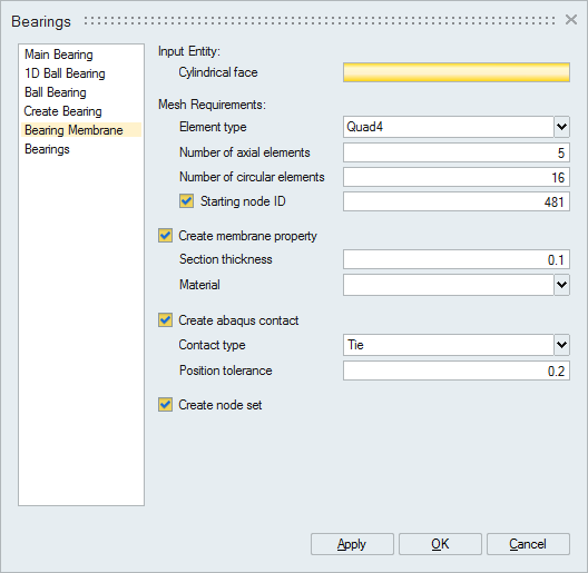

Dialog box
The Membrane mesh option is used to create a layer of membrane elements (Tri3 or Quad4) at the inner bearing surface.
The Membrane mesh tool also has option to,
  • Specify starting node Id.
  • Create membrane property.
  • Create abaqus contact between membrane surface and bearing surface.
  • Create a node set of the nodes in the membrane body.
