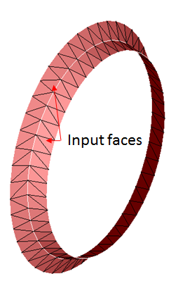

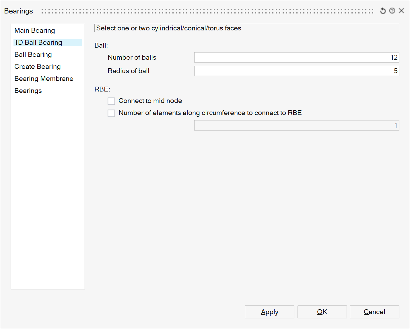

Ball bearing is represented by using rigids and connecting them by springs. This tool enables the user to create rigids on inner and outer races. User has to create the rigids for inner and outer races separately and connect them by spring. Based on the number of balls, the elements along the circumference of the races will be equally divided and connected to the rigids automatically. User can also specify the number of elements along the circumference to connect to the rigids.
Example
