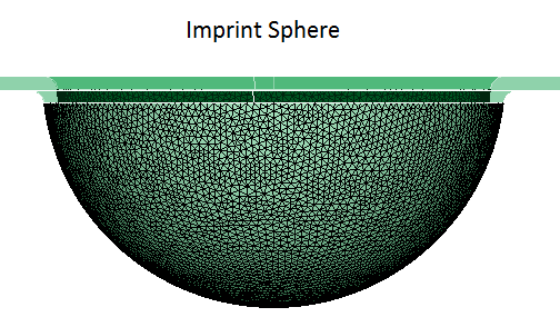

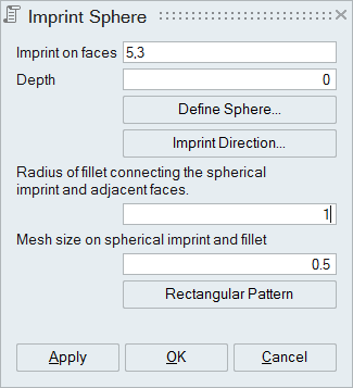

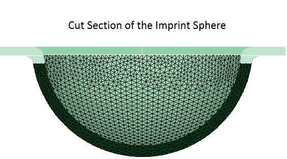

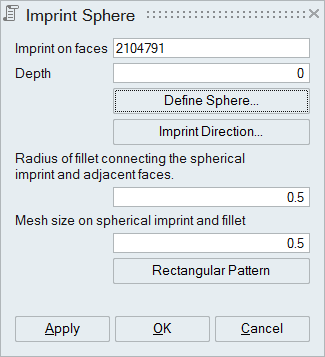

This is used to imprint the sphere on the selected surface.
Imprint on facesFaces on which sphere has to be imprinted.
DepthDistance between the input face and the sphere surface along the imprint direction.
Imprint DirectionDirection in which sphere has to be imprinted on the given surface.

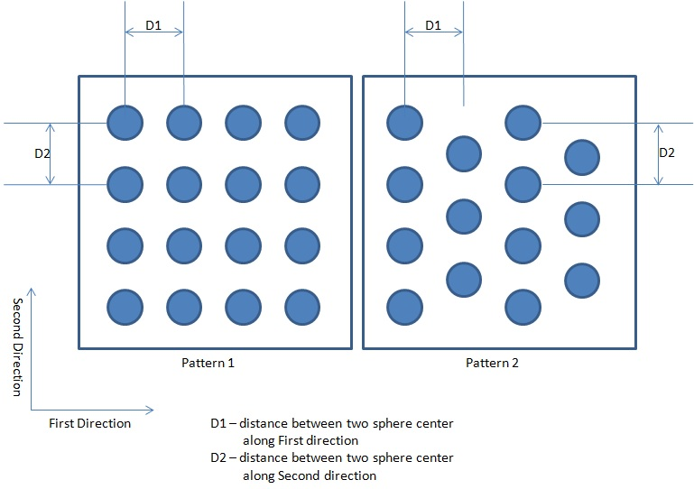

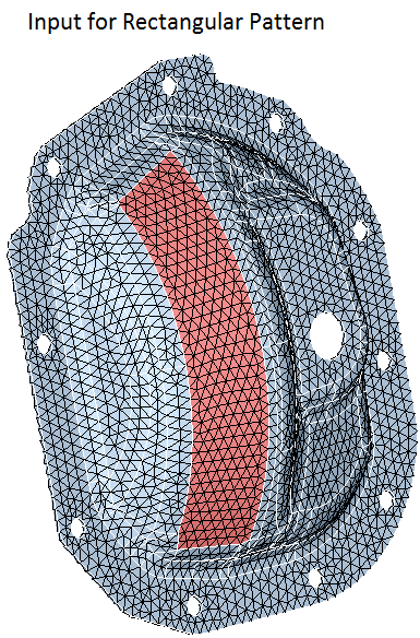

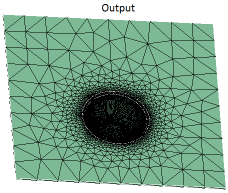

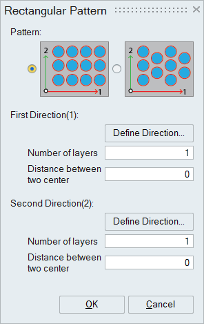

Rectangular PatternRectangular pattern option is used to imprint array of sphere on the given surface. User can specify anyone or both the direction to imprint sphere. There are two types of pattern.

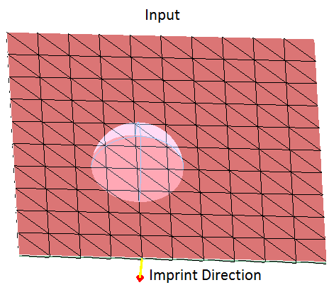

Example 1

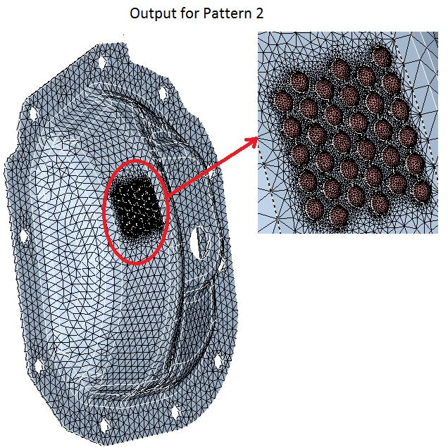

Example 2 (Rectangular Pattern)
