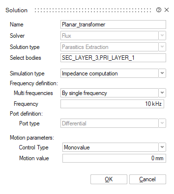

Monovalue Motion parameters allow to solve for one position defined by an offset distance or angle (respectively for translation and rotation) applied on the initial position.

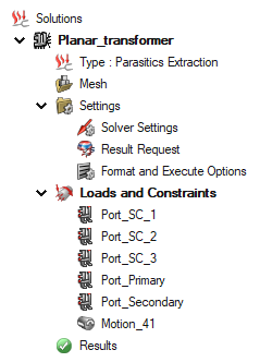

    → The Motion is created and appears in the Solution Browser (2nd tab) in the node Loads and Constraints

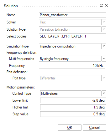

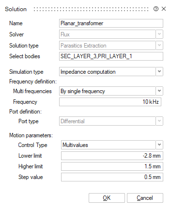

  6. Once the motion entity is created, the motion has to be piloted for the solving. This has to be done in the Solution box which contains now Motion parameters inputs.
    1. Click on the Edit solution button:
      → The solution box contains now Motion parameters inputs with by default Monovalue control type set to 0.
    2. We will choose for this example Multivalues motion parameters to solve at different positions.
      • Select Control type: Multivalues
      • Enter Lower limit distance value
      • Enter Higher limit distance value
      • Enter Step value distance value
    3. Click on OK
      → The project is ready to be solved.

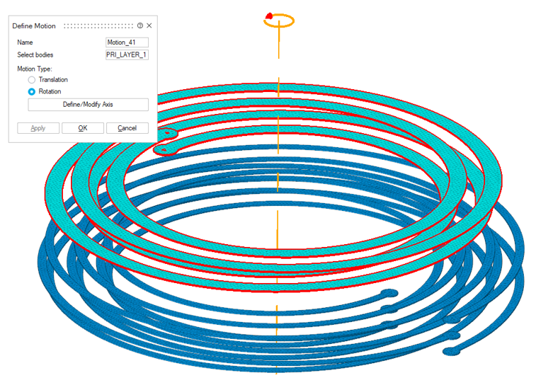

  1. Click on the Motion button:
  2. Select bodies which are moving.
    → The selected bodies are highlighted, and the corresponding field in the dialog box is filled with selected bodies names.
  3. Select Motion type as Rotation
    → The preview of the default rotation axis is displayed (Z axis) which is the right one on this example.
  4. If needed, it is possible to open Define/Modify Axis to select another rotation axis.
  5. Click on Ok.
