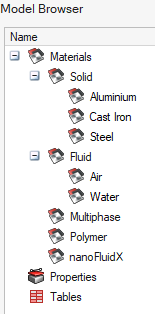

We can see the materials, in the Property Browser (5th tab):
Here are the characteristics of the 4 predefined materials having magnetic properties:
  • 3 Solid Materials: Aluminium, Cast Iron and Steel
    Aluminium Cast Iron Steel

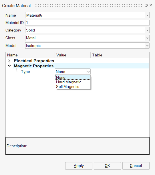

In order to create materials, In the Analysis ribbon click on click on Material and click on Create .
It opens the Create Material dialog box:
In MAC 2D and 3D solutions, you can create 1 type of magnetic materials:
a Soft Magnetic material

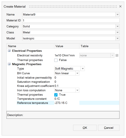

About Thermal properties
For electromagnetic analysis thermal properties can be defined for:
  1. Electrical properties:
    In case of electrical properties, temperature dependence can be defined for the electrical resistivity. Here the electrical resistivity is defined as a linear function of the temperature.
  2. Magnetic properties:
    1. Soft Magnetic material: In the case of soft magnetic materials, thermal properties can be defined for non-linear BH curve type. In this case the B(H) behaviour law is defined as an exponential function of the temperature.
Warning: The working temperature of the bodies should be defined using the Temperature. For more information, please see Temperature.

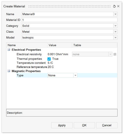

Steps for creating materials
  1. Click on the Create
  2. Enter a name for the material.
  3. You can keep the default values in the 4 following fields:
    • Material ID
    • Category: Solid
    • Class: Metal
    • Model: Isotropic
    Note: This information has no impact on the electromagnetic simulation.
  4. Define magnetic properties: Magnetic Properties.
    Warning: In MAC 2D and 3D, Hard Magnetic material cannot be used.
  5. Enter the characteristics of the material.
  6. Click on the OK button.
    The material is created.
    You can see it in the Property Browser (5th tab).

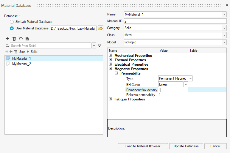

Open the Material Database manager

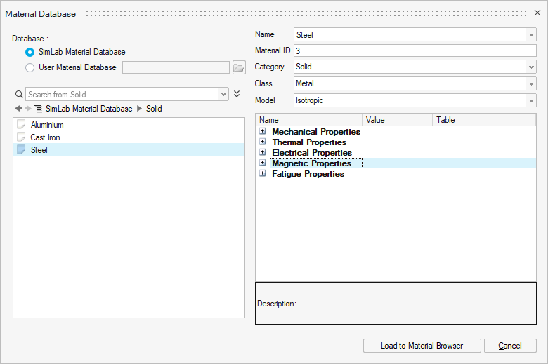

In order to open the material database manager, click on the Built-in DB
It allows to open:
  • the SimLab Material Database
    You can import materials from the predefined SimLab Material Database into the SimLab project using the Load to Material Browser button.
    This database contains many materials of electric, hard magnetic and soft magnetic types.
  • a User Material Database if you have already created one
    You can import materials from a User Material Database into the SimLab project using the Load to Material Browser button.
    You can modify the material properties using the Update Database button.

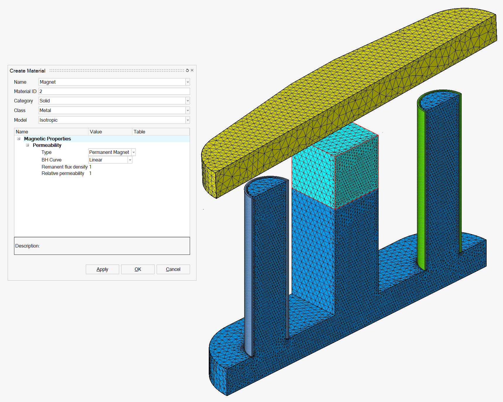

  1. In the Create Material window:
    After having entered the material properties, you can select the body which is composed of this material (the outline of this body is displayed in red), and then click on the OK button.

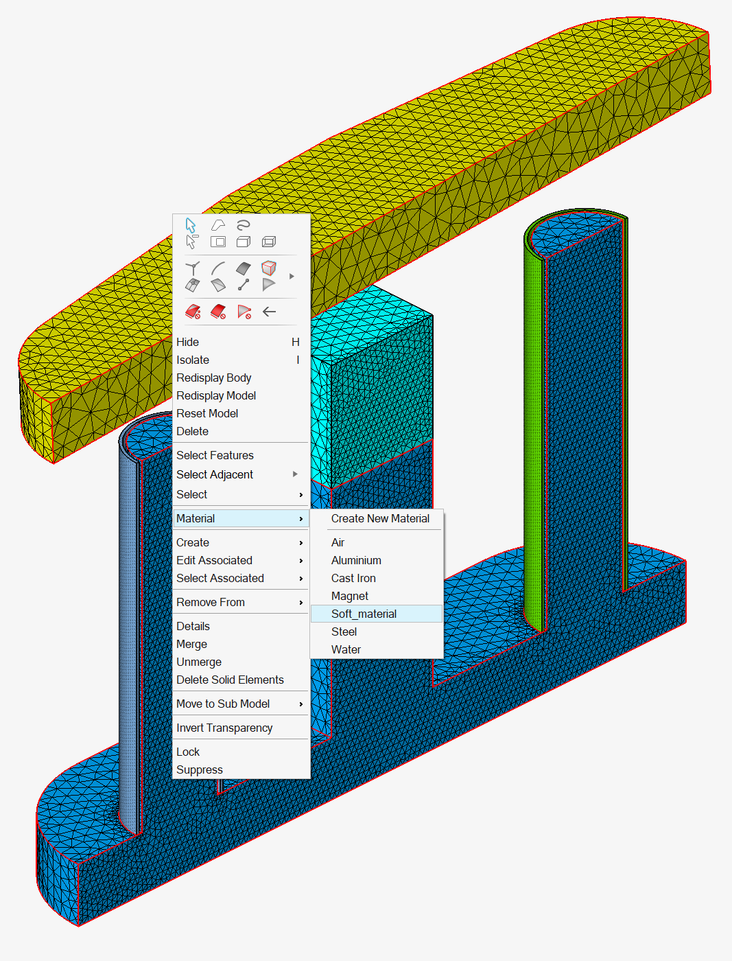

  2. In the graphic window:
    After having created the materials, select the body you want to assign a material to (the outline of this body is displayed in red), then right-click and select the contextual menu Material and then select the wanted material.

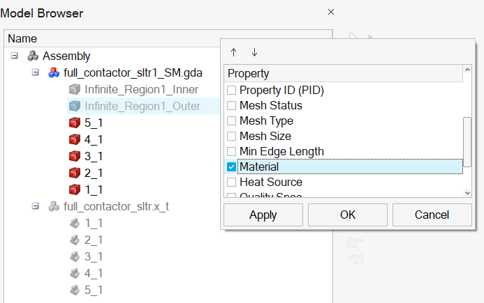

  3. In the Assembly Browser (1st tab):
    1. Display the Material column:
      Right-click on the Name column title bar then check Material and then click on the OK button.
    2. Assign the material to the body:
      After having created the materials, in the column Material and in front of the body (of the .gda model), left-click and then select the material you want to assign to this body.

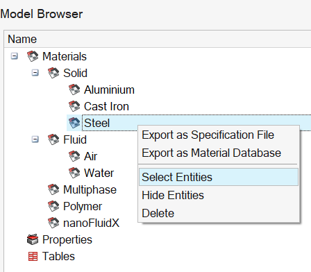

In the Property Browser (5th tab), right-click on a material and the 2 contextual menus Select Entities and Hide Entities allow you to select and hide the bodies assigned to a material.
