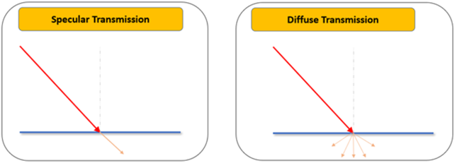

- Specular transmissivity (τs): Occurs when a photon passes straight through a surface with no change of direction.
- Diffuse transmissivity (τd): The photon penetrates the surface, but its outgoing energy is uniformly distributed in solid angle over the hemisphere, weighted by projected surface area.

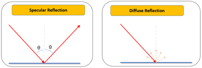

- Specular reflectivity (ρs): The angle of reflection is equal to the angle of incidence.
- Diffuse reflectivity (ρd): These are similar to diffuse transmissions, except the hemisphere over which the outgoing energy is distributed is on the same side of the surface as the incident photon.
