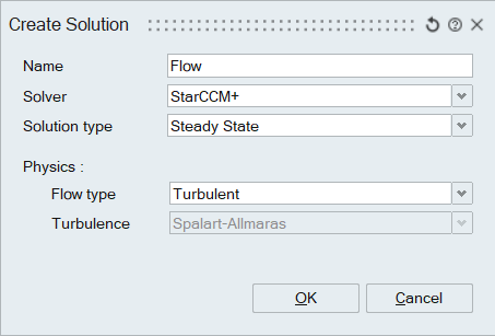

Flow Solution is used to analyze general fluid flow problems that is used in a wide variety of applications and industries. The flow solver is architected for parallel execution on shared and distributed memory computer systems and provides fast and efficient transient and steady state solutions for standard unstructured element topologies.
A variety of physics is supported including different turbulence models, heat transfer, radiation models, multiphase and moving bodies. You need to select the required physics to be solved in the Solution panel. Accordingly, boundary conditions, solution parameters, material creation and assignment will be setup to run a Flow simulation, launch the solver and visualize the results.
Use SimLab - Learning center videos for more tutorials on Model setup using Solution approach.CFD Mode is supported for flow solution, it displays the entities on which boundary conditions are applied in colors.
Solution type
Two different Solution types are supported:
  • Steady State
    The time dependence of flow field parameters is an important factor in the analysis of a fluid flow. In a steady state flow, the flow properties at a point, such as pressure and velocity, do not change with time. Steady state flows are of interest in cases where the flow properties need to be studied after the flow field has stabilized.
  • Transient
    If the flow is not steady, then it is said to be unsteady or transient. For a transient simulation, time step size and the total run time needs to be provided. Time step size is the value of time increment made for each time step during a simulation and the Final time is the total physical time the simulation should be performed. Time step size can be ramped up or down during the simulation using a Multiplier Function.

Flow
Flow must be set to None, when there is no flow being modeled in the simulation. This option can be used for Frozen flow simulations where the flow variables are mapped as initial conditions and not solved during the simulation. This option can also be used for modeling heat transfer through solid bodies.
Flow must be set to Laminar,if the fluid motion is characterized by smooth layers and the Reynolds number is within the laminar flow range depending on it is an internal or external flow.
Flow must be set to Turbulent,when the fluid motion is expected to be highly disordered that typically occurs at high velocities and is characterized by velocity fluctuations. Appropriate Turbulent model needs to be selected.
Turbulence
If Flow is set to Turbulent, Turbulence option is displayed. SimLab supports a variety of turbulence models such as Spalart Allmaras, Shear Stress Transport (SST), K-Epsilon and K-Omega. . It also includes Spalart Allmaras DES, and Shear Stress Transport DES for transient analysis. Depending on the problem being solved, an appropriate turbulence model needs to be selected.
