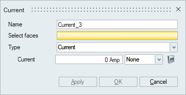

Current
This panel is used to define electrical current.

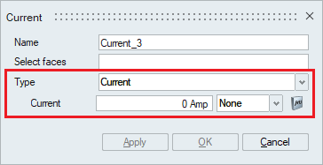

Type
The current can be defined in two methods, Current and Current density.
Current
Value of the total current at a surface.
- Current density
Value of the total electric current density normal to the surface.
