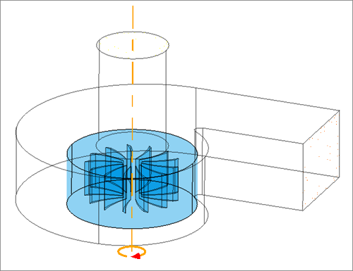

- Axis of rotation

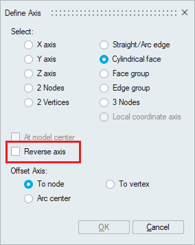

Select Define/Modify Axis to specify the axis of rotation. In the Define Axis panel, any of the displayed options can be used to define axis of rotation.

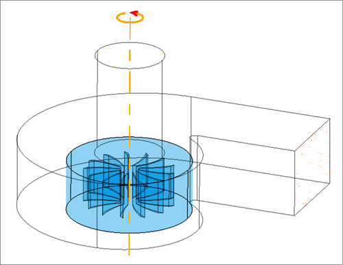

The Reverse axis option is used to reverse the direction of rotation of a body.
Dialog Box Image
