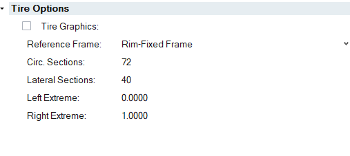

Tire Graphics Section
The Tire Graphics check box can be used if you wish to see a deformable tire graphics while post-processing in HyperView.
For CDTire, Fiala and Simcenter MF-Tyre/MF-Swift, the check boxes can be used to switch ON/OFF the deformable graphics in the animation.
For Cosin FTire, a few additional parameters are presented as inputs:
The following five inputs are needed for creating the tire graphics:
| Reference Frame | The frame of reference for the graphics. Options are:
This option renders the graphic in the tire force reference marker. |
| Circumferential Sections | Number of divisions along the circumference. |
| Lateral Sections | Number of divisions along the tire width. |
| Left Extreme | Beginning point of graphics on left side of tire. 0 indicates left rim flange. |
| Right Extreme | Ending point of graphics on right side of tire. 1 indicates right rim flange. |
