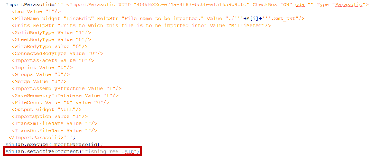

Let us consider an Assembly with large number of Sub-Models and we need to export each Sub-Model as a separate database and open them side by side. In this process we need to return to the database containing the assembly after opening the previously exported Sub-Model database in order to export the remaining Sub-Models. By using this utility, we can set the database containing the assembly as active one.
Sample
Note: Sample Script
