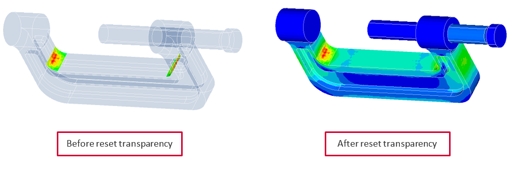

This utility is used to reset all transparency faces in a database.
Syntax
simlab.resetTransparency()
Use Case
During the snapshot of the critical region results, some of the bodies and faces will be made transparent. This utility will be useful to reset the transparency of the faces after capturing snapshot.
Why we need this utility?
Reset transparency function could not be recorded as it does not have the script support. In order to overcome this, we can make use of this utility to reset all transparency faces in a database.
