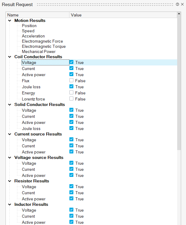

The Result Request allows the user to select the list of global quantities that he wants to postprocess in function of another parameter (position, time…).
Note: Result Request entity exists by default in the solution. Some quantities are checked by default. It is possible to change the quantities to post process by clicking on the Result Request button or by editing the existing entity in the solution datatree (in Settings).

By default, the predefined quantities of the motion are displayed (and cannot be modified), and the user has the choice to add or remove the other quantities. The list of these proposed quantities is in this dedicated GUI and depends on the studied solution (MS2D, MS3D, MT2D...).
Export H3D Result files: this option has been added to support the exports or not of the graphical result contours for Magnetostatic Integral and AC Supplied Conductors. This option can help to save time in cases of Design of Experiments, when it is only interesting to see global values. This option is enabled by default.

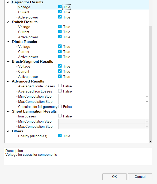

Advanced Results Joule Losses
(* Averaged Joule Losses)
Iron Losses
(* Averaged Iron Losses)

Advanced Results
The Result Request Advanced Results is deactivated by default.
However, user can define it if required.
  • this result request is used for computation of coil and magnet losses and to export them in H3D format.
  • This can be useful when trying to couple the transient magnetic solution to a CFD computation.
  • With the help of the H3D files the losses can be directly mapped to the FLOW solution, when they will be used as heat source loads.
  • Options are given for extrusion and building or not the full geometry considering the periodicity.
