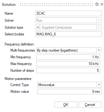

Once the motion entity is created, the Solution box content is updated with Motion parameters inputs to pilot the motion during the solving:
Solution with Monovalue Motion parameters Solution with Multivalues Motion parameters
Monovalue Motion parameters allow to solve for one position defined by an offset distance or angle (respectively for translation and rotation) applied on the initial position.

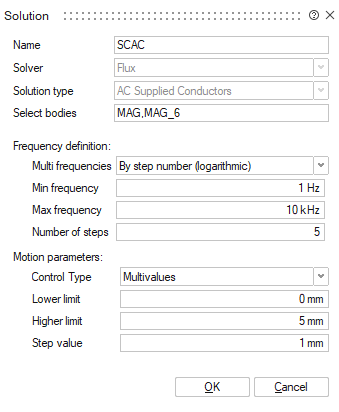

Multivalues Motion parameters allow to solve for several positions defined by a Lower limit, a Higher limit and a Step value. Those values correspond to distance or angle offsets (respectively for translation and rotation) applied on the initial position.

  6. Once the motion entity is created, the motion has to be piloted for the solving. This has to be done in the Solution box which contains now Motion parameters inputs.
    1. Click on the Edit solution button:
      → The solution box contains now Motion parameters inputs with by default Monovalue control type set to 0.
    2. We will choose for this example Multivalues motion parameters to solve at different positions.
      • Select Control type: Multivalues
      • Enter Lower limit distance value
      • Enter Higher limit distance value
      • Enter Step value distance value
    3. Click on OK
      → The project is ready to be solved.
