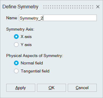

Dialog box
- Symmetry Axis: The device can be symmetric with respects to X and/or Y axis. If the device is symmetric with respects to both axis, two Symmetry entities must be created with each axis.
- Physical Aspects of Symmetry:
This option is necessary to define the direction of the magnetic field near the axis of Symmetry.
The magnetic field can be either Normal field or Tangential field. For more information, please refer to Symmetry conditions on boundaries.
