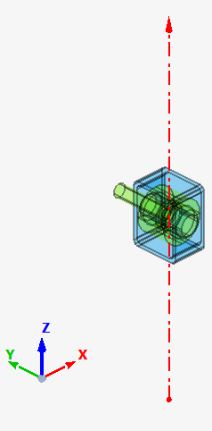

      The following example illustrates it:
      It is mostly used for translating motion.

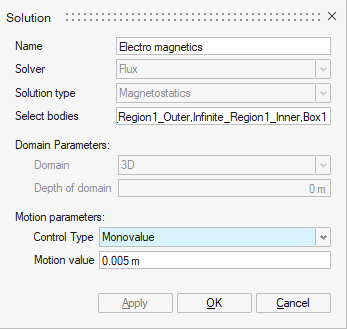

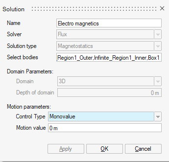

Monovalue Motion parameters allow to solve for one position defined by an offset distance or angle (respectively for translation and rotation) applied on the initial position.

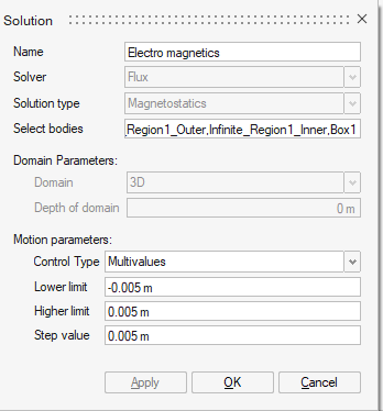

Multivalues Motion parameters allow to solve for several positions defined by a Lower limit, a Higher limit and a Step value. Those values correspond to distance or angle offsets (respectively for translation and rotation) applied on the initial position.

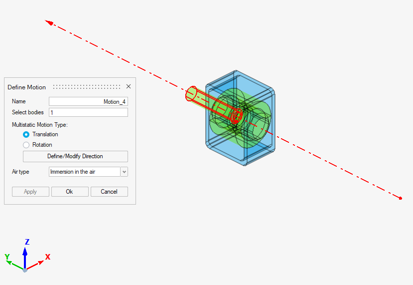

  1. Click on the Motion button:
    → A default direction of the translation with an arrow on Z is visible at Motion box opening. This will be changed in following steps.
  2. Select bodies which are moving. In this case, the body highlighted in red in the upper image.
    → The selected bodies are highlighted, and the corresponding field in the dialog box is filled with selected bodies names.
  3. Select Multistatic motion type as Translation
  4. Open Define/Modify Direction. Select Y axis and OK.
    → The preview of the translation direction is correctly updated.
  5. Check that Air type is set to Immersion in the air (default choice for Translation).
  6. Click on Ok.

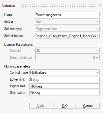

  7. Once the motion entity is created, the motion has to be piloted for the solving. This has to be done in the Solution box which contains now Motion parameters inputs.
    1. Click on the Edit solution button:
      → The solution box contains now Motion parameters inputs with by default Monovalue control type set to 0.
    2. We will choose for this example Multivalues motion parameters to solve at different positions.
      • Select Control type: Multivalues
      • Enter Lower limit distance value
      • Enter Higher limit distance value
      • Enter Step value distance value
    3. Click on OK
      → The project is ready to be solved.

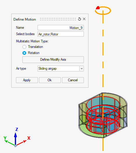

Steps for Rotation
In this section, we will show the steps for rotation case on an example of a rear-view motor:

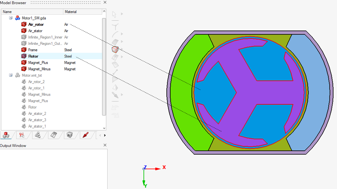

  2. Select bodies which are moving. In this case, the bodies "Rotor" and "Air_rotor" highlighted in red in the following image are selected. "Air_rotor" corresponds to the moving airgap part (it is touching the body "Air_stator" on the sliding surface).
  3. Select Multistatic motion type as Rotation
    → The preview of the default rotation axis is displayed (Z axis) which is the right one on this example.
  4. If needed, it is possible to open Define/Modify Axis to select another rotation axis.
  5. Check that Air type is set to Sliding airgap (default choice for Rotation).
  6. Click on Ok.
    → The Motion is created and appears in the Solution Browser (2nd tab) in the node Loads and Constraints
    Please follow Step 7 of Steps for Translation and enter the angular offset positions (in degree) to be simulated.
