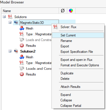

Advices
  • In the same project, it is possible to create several solutions.
    The active solution is the one in bold in the Model Browser (to the left of the graphic window), in the 2nd tab Solutions.
    Tip: In order to choose the solution to work on: right-click on the solution and select the contextual menu Set Current.
    Within the same project, having several solutions, allows you to:
    • do multiphysics (with coupling)
      Note: There is no multiphysics with a 3D Magnetostatic solution.
    • simulate several projects in parallel (with no coupling)
    The interest is that the geometry and the mesh are created only once, there is no need to redo the geometry and the mesh.
  • It is possible to Export and open in Flux at any time, as long as the bodies are meshed and assigned to the solution.
    Use the right click on the Solution to open the contextual menu, and click on Export and open in Flux.
