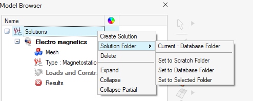

Storage of files
During the solving all the Flux files are stored in a path. This path can be defined through the contextual menu of Solutions in the Solution Browser:
  1. Set to Scratch Folder takes the Scratch folder specified in the Preferences dialog box (accessible in the File menu) in the category Application > General, in the field Scratch directory as the path for all the simulations.
    By default it is C:/Users/...
    The files are stored in the solved solution name folder inside the SolverRun folder.
  2. Set to Database Folder takes the same location as the active *.slb database. The files are stored in the solved solution name folder inside a folder having the *.slb name.
  3. Set to Selected Folder allows to choose the path where all simulations files will be stored.
    The files are stored in the solved solution name folder.
Note: The first line beginning with Current : indicates the current selected path. In this image it is Database Folder.
