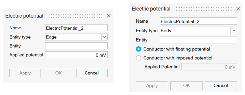

It is possible to define an electric potential (V0) on a region by:
- Applying potential on the boundary by selecting the edges of the body.
- Applying floating or imposed potential on a perfect conductor body.
Note:
- When importing the Nastran deck in flux, each of the selected edges will have separate line regions.
