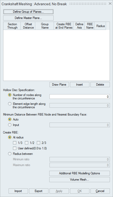

In this option, we create solid mesh along with RBE's at the user defined locations in the crankshaft.
The difference between the Advanced crankshaft meshing and this option is that crankshaft is not split. But internal faces are created and do not intersect with the surfaces.
