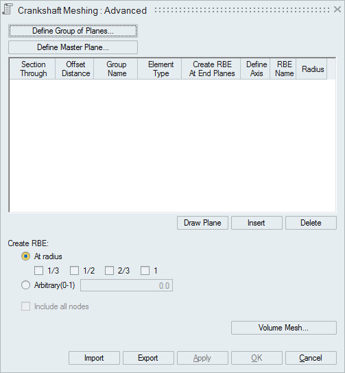

In this option, we create solid mesh along with RBE's at the user defined locations in the crankshaft.
We creates internal faces to the solid at the specified plane locations. Oil holes that cross the plane will also be broken by the plane. At each internal face, RBEs will be created with the master node on the axis of the journal or pin and the slave nodes at a requested radius from the axis.
