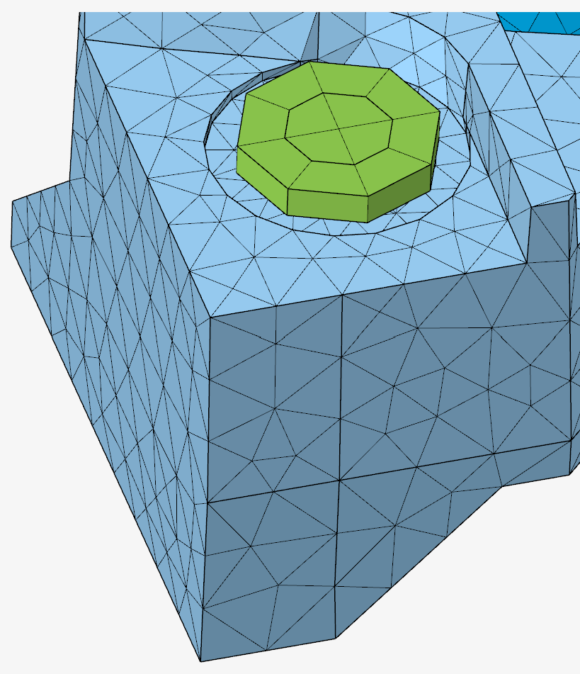

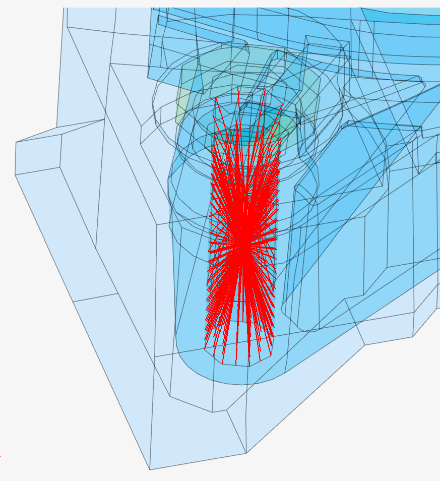

This tool identifies the mating bodies for the given bolt bodies and connects them with the bodies by one-dimensional rigid elements. It creates two rigid elements, one for each bolt and body, and a rigid element that connects these two rigid elements. Most of the time, bolts may be merged into a single body. This tool enables the creation of connections even for merged bolt bodies.
