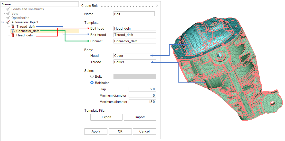

Set environment variable "set SL_CREATE_1D_BOLT_USING_TEMPLATES=true" to enable this option.
This tool enables user to create 1D bolts between two bodies by selecting template definition for head, thread and connector. Look at creating templates for head, thread and connector.
1D bolts can be created either by selecting the CAD/Mesh bolts or the bolt holes can be identified by defining gap between two bodies and diameter range to find bolt holes.
