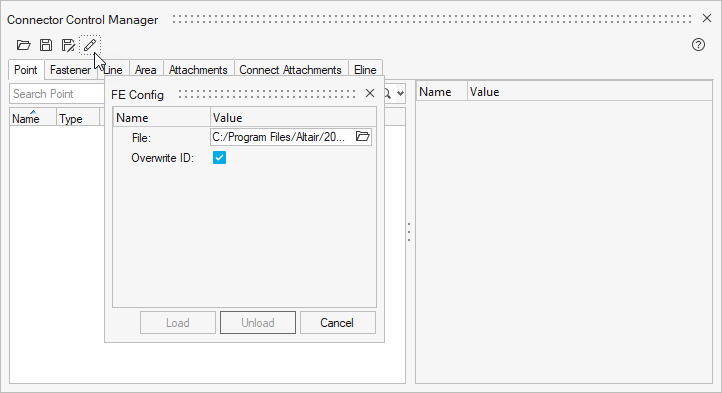

The configuration file can be manually loaded via the Control Manager.
The configuration file can be automatically loaded when HyperMesh launches. When launched, HyperMesh searches for the feconfig.cfg

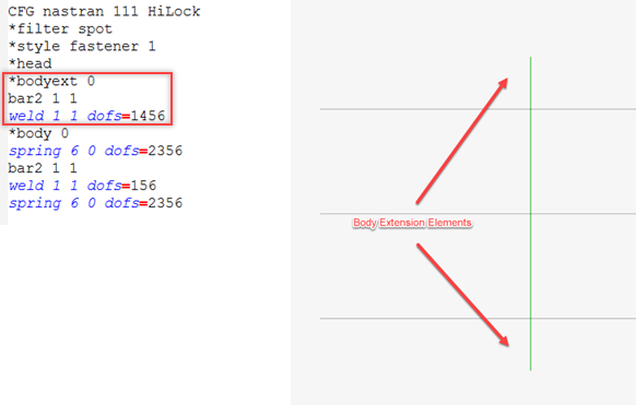

<HM_FE_CONFIG> <HM_FE_TYPE> <RIGID_FLAG> [<DOFS>]
*bodyext <BODY_FLAG>

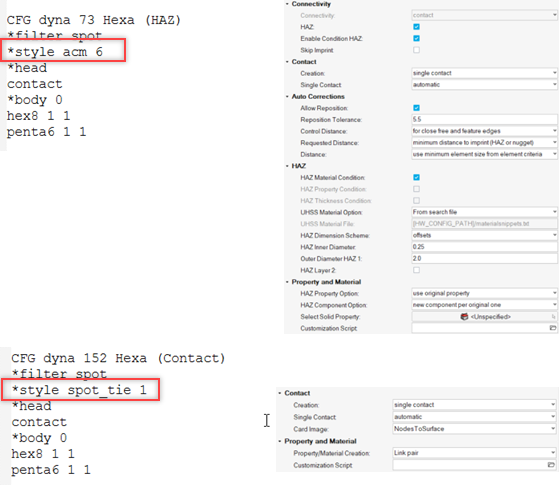

*filter <CE_TYPE>*filter <CE_TYPE>can be used to allow only the specified connector types to realize the configuration.*style <STYLE_TYPE> <STYLE_NUM>- The

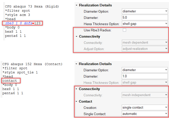

*styleoption indicates that the configurations have specific behaviours associated during realization, and that they are native types. *head- The
headstring is required to specify that a rigid, 1D, or contact is to be created to connect the weld node to the surrounding shell element. *bodyext- The
bodyextstring is required to specify that the body of a weld has an extension associated with it. Currently, this extension can be created by a group of weld elements protruding at a distance of 0.5*times the thickness of the connected shell elements.*bodyextlines may be followed by one or moreHM_FE_CONFIGlines. *body- The

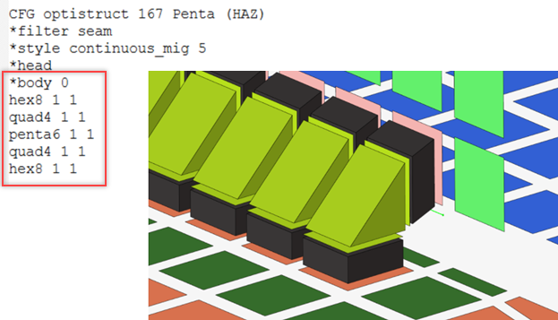

*bodystring is required. *post- The lines are optional, but if specified it must be followed by the name

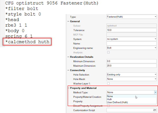

*calcmethod- The
*calcmethodtag can be used to define any valid custom realization (points/fasteners) to have a calculation method.
