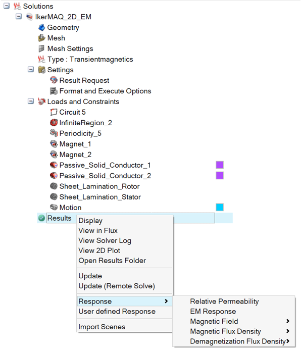

Responses can be used in an individual solution or in a solution setup DOE solution to run multiparametric analysis. Responses can be created under

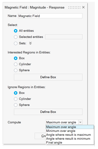

Once user selects one of the above quantities a dialog box is shown where users can select the bodies for computation and options to compute various quantities over the transient computation (Angle or time).

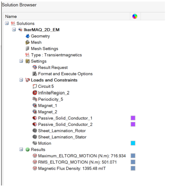

Here must select the quantities they are interested in and the statistical temporal data they want to compute (Max, Min, Avg and RMS).
Once the responses are defined they appear under results in the solution browser. Updating the solution will update the responses (if solution is successfully solved).
