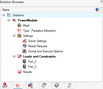

Right click on Results in the Solution Browser > Update
Steps
In the Solution Browser (second tab), right-click on Results and choose Update.
In the Solution Browser, the solving process is in progress, you can see that Results is now preceded by a yellow light.
Note:
  • You can see the solver log by right-clicking on Results and selecting the contextual menu View Solver Log.
  • You can stop the solving by right-clicking on Results and selecting the contextual menu Kill Solving.
→ Once the solving process is completed, the light turns green.

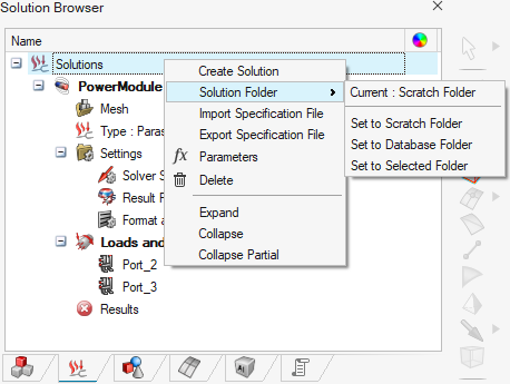

Storage of files
During the solving all the Flux files are stored in a path. This path can be defined through the contextual menu of Solutions in the Solution Browser:
  1. Set to Scratch Folder takes the Scratch folder specified in the Preferences dialog box (accessible in the File menu) in the category Application > General, in the field Scratch directory as the path for all the simulations.
    By default it is C:/Users/...
    The files are stored in the solved solution name folder inside the SolverRun folder.
  2. Set to Database Folder takes the same location as the active *.slb database. The files are stored in the solved solution name folder inside a folder having the *.slb name.
  3. Set to Selected Folder allows to choose the path where all simulations files will be stored.
    The files are stored in the solved solution name folder.
Note: The first line beginning with Current : indicates the current selected path. In this image it is Database Folder.
Note: At the end of solving, the command Open Results Folder in Results contextual menu allows to open an explorer window at the location where all the files were saved.
