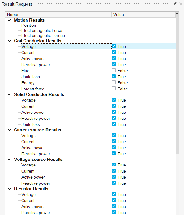

The Result Request allows the user to select the list of global quantities that he wants to postprocess in function of another parameter (position, time…).
Note: Result Request entity exists by default in the solution. Some quantities are checked by default. It is possible to change the quantities to post process by clicking on the Result Request button or by editing the existing entity in the solution datatree (in Settings).
Dialog Box
Dialog Box
List of Result Request for EM Solutions
By default, the predefined quantities of the motion are displayed (and cannot be modified), and the user has the choice to add or remove the other quantities. The list of these proposed quantities is in this dedicated GUI and depends on the studied solution (MS2D, MS3D, MT2D...).
Export H3D Result files: this option has been added to support the exports or not of the graphical result contours for Magnetostatic Integral and AC Supplied Conductors. This option can help to save time in cases of Design of Experiments, when it is only interesting to see global values. This option is enabled by default.

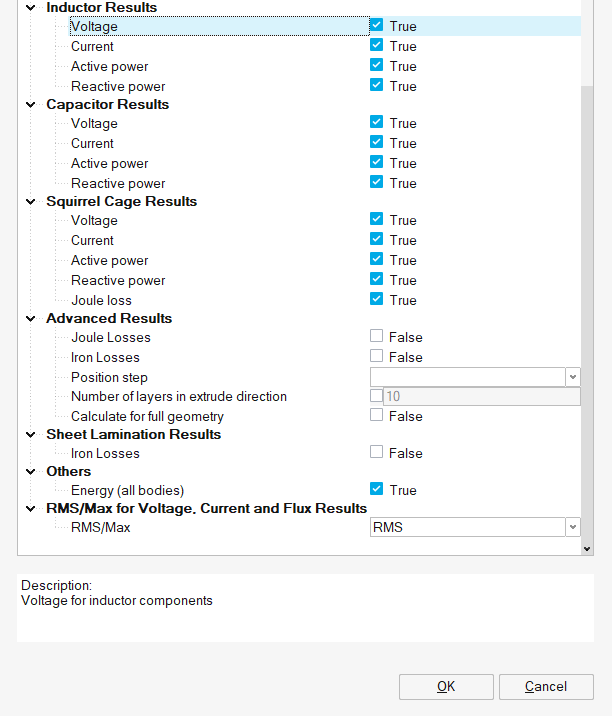

Advanced Results Joule Losses
(* Averaged Joule Losses)
Iron Losses
(* Averaged Iron Losses)
  • Min Computation Step
  • Max computation Step
Position step
Number of layers in extrude direction
Calculate for full geometry
Sheet Lamination Iron Losses
Thin Region Joule loss **
Others Energy (all bodies)
RMS or Max for Voltage, Current and Flux

RMS/Max for Voltage, Current and Flux Results
The RMS/Max option allows to select the type of output for curve, EM Response and contour/vector results.
  • If RMS is selected:
    The Current, Voltage and Magnetic Flux for all components will be in RMS format and will be named Current_Module_RMS_<Component Name>, Voltage_Module_RMS_<Component Name> and Flux_Module_RMS_<Component Name> respectively.
    The contour/vector results for J and B quantities will be in RMS values as well.
  • If Max is selected:
    The Current, Voltage and Magnetic Flux for all components will be in Max format and will be named Current_Module_Max_<Component Name>, Voltage_Module_Max_<Component Name> and Flux_Module_Max_<Component Name> respectively.
    The contour/vector results for J and B quantities will be in Max values as well.
Note: The Joule losses will remain the same for both RMS and Max cases. They are computed using the RMS value of the current.
