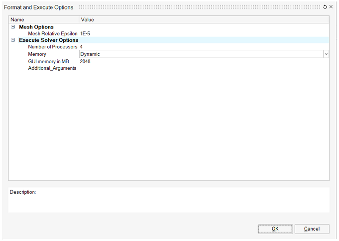

Format and Execute Options
The Format and Execute Options allow the user to set the options which will be taken by Flux solver (in batch) to solve the current solution.
Mesh options
Mesh Relative Epsilon allows to define the limit to consider two nodes as superimposed or not.
The Mesh absolute Epsilon is computed by multiplying the Mesh Relative Epsilon (1e-5 by default) by the diagonal of the bounding box of the solution bodies.
The distance between two nodes is compared to the Mesh absolute Epsilon value: if it is lower then the nodes are considered as superimposed.
Execute Solver Options
The Execute Solver Options define the options used at Flux
solver execution:
- Number of Processors used to parallelize the solving process
- Memory used by Flux solver. By default, the memory is set to Dynamic memory allocation. It is possible to switch to a user defined memory (static memory) and specify the amount of memory to allocate
- GUI memory defined statically by a given memory amount
- Additional_Arguments is an advanced option to add additional arguments information like system memory, PEEC memory and so on. Input should be space separator. Example: -fluxncores 4 -memsizn3_mb 6000 -memsizc3_mb 200
