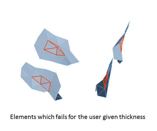

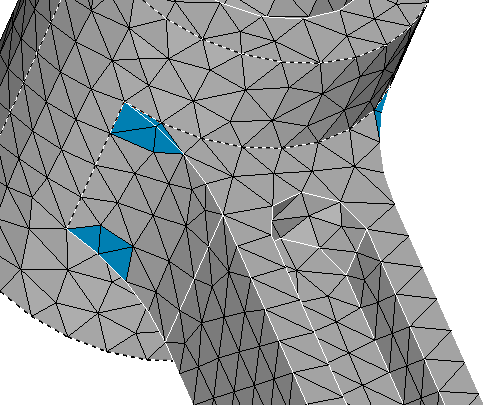

Mesh | 3DCreate | Layered Elements automatically changes the thickness at nodes to achieve better quality or to avoid element intersections. This option is used to identify those regions and user can do the cleanup to avoid thickness correction. The identified element regions will be created as groups based on connectivity.
