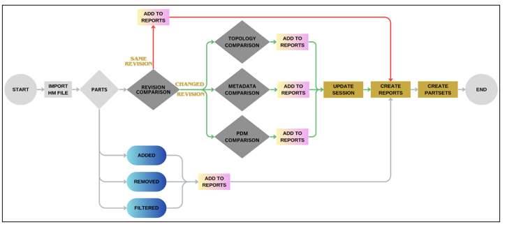

Model Update is a process to compare and review changes between two models.
This functionality compares parts by Revision (Revised or Unchanged) and detects differences and changes in the following categories: Topology, PDM data and Metadata. After the comparison, the session’s model is updated to match exactly the imported model. The report provides additional information on filtered, new and removed parts between the two models.
Model Update is based on four basic steps:
  1. Compare revision for all of the parts.
  2. Compare the revised parts for topology changes.
  3. Compare the revised parts for metadata changes.
  4. Compare the revised parts for PDM changes.
After the Model Update process, report file and part sets are created to review the changes.
Revision Comparison
The first step in the Model Update process is the revision comparison. Based on the selected comparison rule:
  • Every part that has a changed revision will be marked as Revised, and it will be compared.
  • Any part that has exactly the same revision will be marked as Unchanged and will be skipped from comparison.
Every revised part will be compared with the incoming one for topology, metadata and PDM changes, and reports and part sets will be created based on the results.

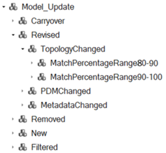

Update Session
After the completion of all of the above, the session will be updated to match the incoming model. Based on the results, part sets will be created for each category to review the changes.

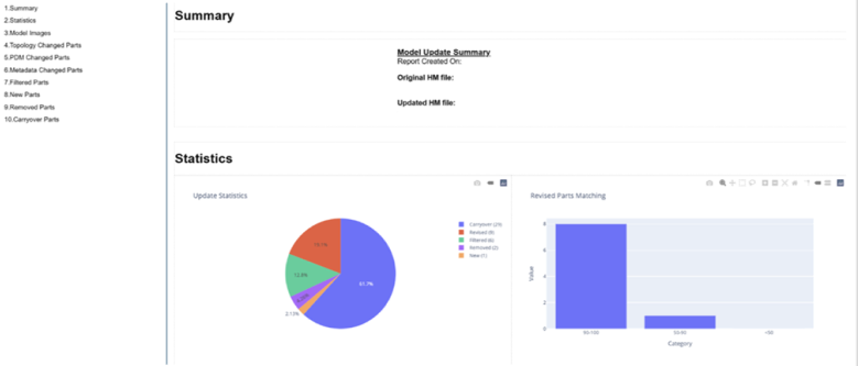

Reports
When Model Update finishes, HTML reports will be created. These reports will help you to track and review all of the changes made in the model in an organized way. Reports present a comprehensive summary of comparison results on a structured page, where you can navigate through categories and find useful information about the model.
