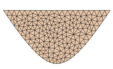

Example of HP card usage
The plate with a hyperbolic border shown in Figure 2 is created using the HP card.
