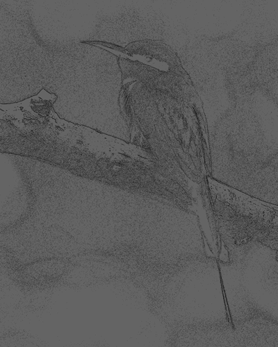

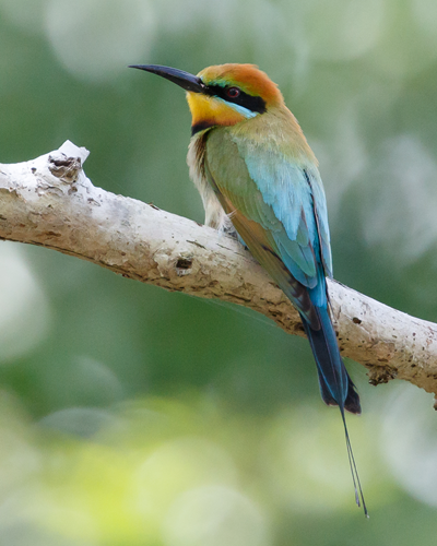

Apply adaptive threshold to the given image:
Figure 1. Input image
Figure 2. Output image
src = imreadcv('bird1.jpg', 0);
m = 100;
method = 1;
ttype = 0;
blocksize = 3;
constantval = 5;
R = adaptivethresholdcv(src, m, method, ttype, blocksize, constantval);

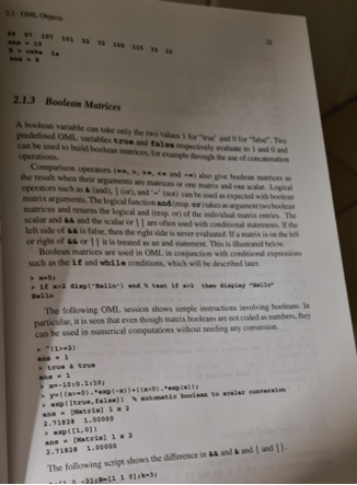

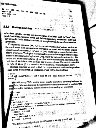

Apply adaptive threshold to remove the shadow on a book page:
Figure 3. Input image
Figure 4. Output image
imgoriginal = imreadcv('adaptivethresholdcv_fig3.png',1);
figure(1);
imshowcv(imgoriginal);
%Conver the image to gray scale
img = cvtcolorcv(imgoriginal, 6);
%Apply thresholding technique
thresh = adaptivethresholdcv(img, 255, 0,0, 199, 5)
figure(2);
imshowcv(thresh);
