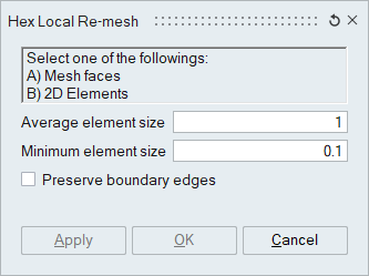

This tool helps the user to re-mesh a portion of the hex meshed body with different mesh size. User can select a set of elements or faces and do re-mesh.
The Average element size is the average element edge length of the shell element.
Minimum element sizeThe Min Element Size is used to remove all the elements that have element edges less than this value.
Preserve boundary edgesWhen the toggle is selected, the boundary of the selected elements or faces will be preserved. When the toggle is not selected, few layer of adjacent elements will also be re-meshed.

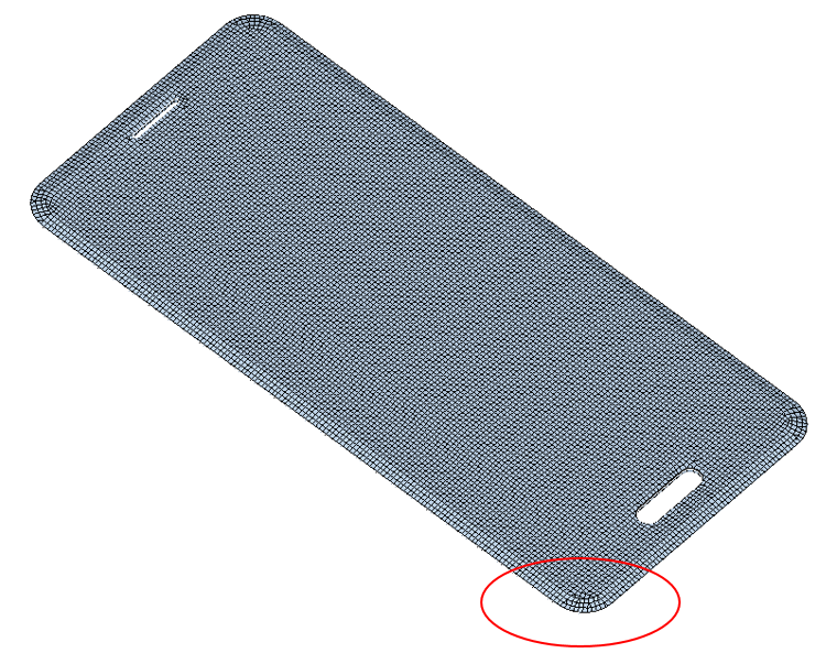

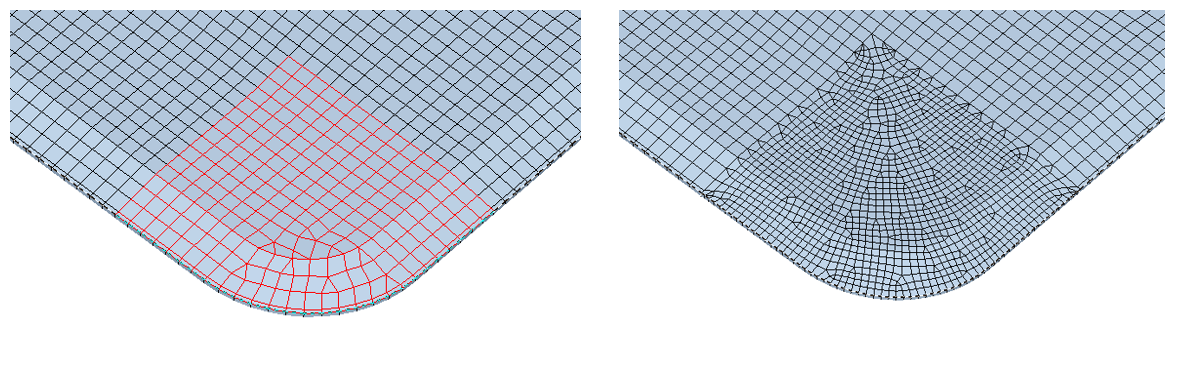

Example:
Preserve boundary edges =
OFF
Preserve boundary edges = ON
