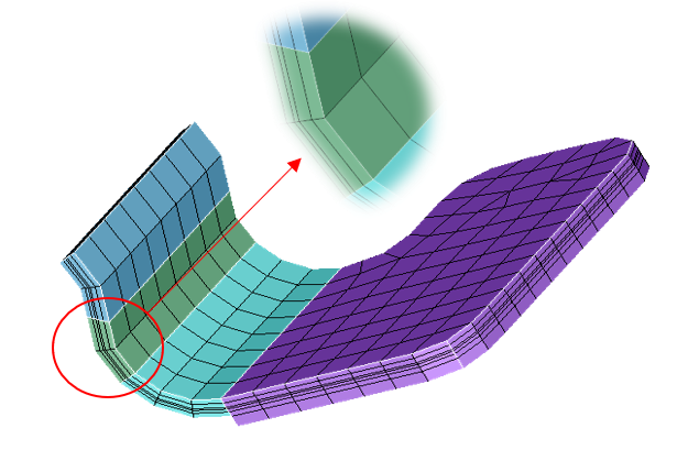

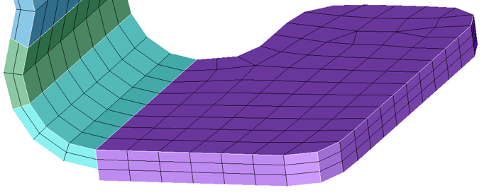

- Matching mesh: This requires the node to node matching between the two bodies that need to be connected. Two or more bodies can be selected as input. The mesh or number of layers in the extrude direction of the bodies need not be the same. Refer fig.(a) for details.

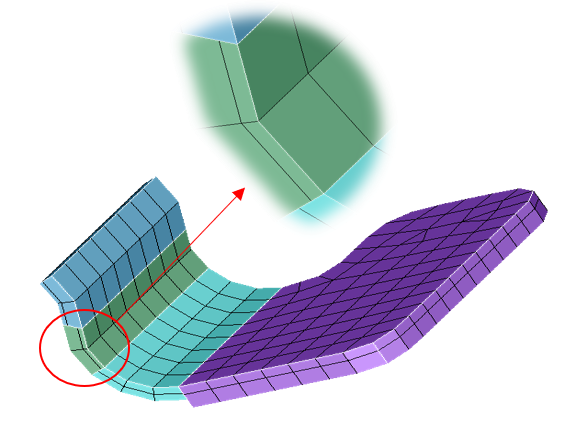

- Non-Matching mesh: This does not require the node to node matching between
the two bodies. Only two bodies can be selected as input. The first body will be
preserved and the mesh on the second body will be modified locally to match with the
first body. Refer fig.(b) for details.

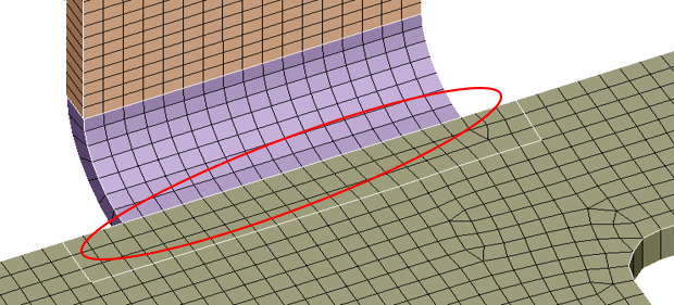

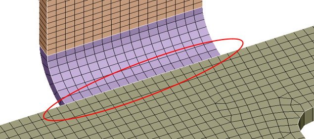

Example 1: Side face(Matching mesh)
Input
Output

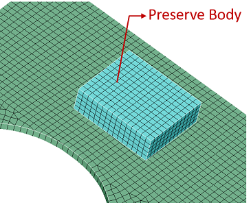

Example 2: Side face(Matching mesh) - Preserve body option
Input

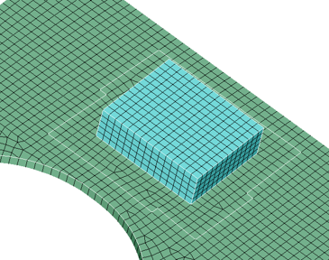

Example 3: Side face(Non-Matching mesh)
Input
Output

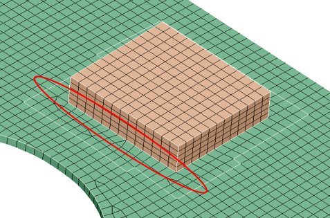

Example 4: Top face
Input

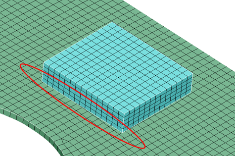

Example 5: Top face - Preserve body option
Input
Output
