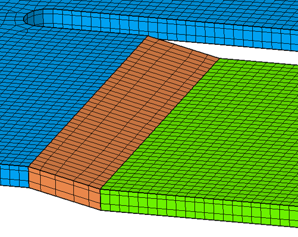

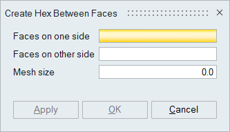

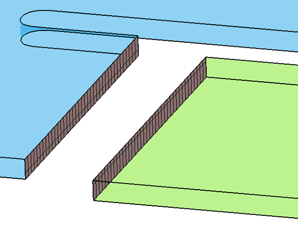

This tool is used to generate a Hex mesh body between two sets of input quad faces. Select faces on both sides and specify the mesh size. It will create a Hex mesh body with matching mesh between the selected faces.
Input
Output
