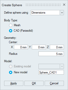

Create Sphere
Geometry > Body > Create > Primitives > Sphere
Dialog Box
CAD Body Type Mesh Body Type

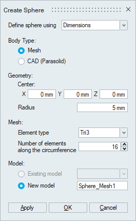

This tool is used to create a sphere for the given radius.
  • Define sphere using
    • Dimensions
      Center: Users can pick a node or a vertex to define the center or enter the coordinates value directly.
      Radius: Enter the radius of the sphere.
    • Bounding Body
      Pick a body to define the sphere whose radius can be modified using the radius line edit.
    • Straight/Arc edge: Pick a straight or arc edge to define the sphere.
      Straight edge: The edge length is regarded as the diameter of the sphere, while the midpoint of the edge serves as the sphere center.
      Arc edge: The arc radius is regarded as the sphere radius, while the arc center serves the sphere center. The radius of the selected arc edge is the arc radius.
    • Spherical face
      Pick a spherical face to define the sphere.
    • 2 Nodes
      Pick two nodes to define a sphere. The diameter will be the distance between the two nodes, and the center will be the midpoint of the two nodes.
    • 2 Vertices
      Pick two vertices to define a sphere. The diameter will be the distance between the two vertices, and the center will be the midpoint of the two vertices.
  • Body Type
    • CAD: To create a CAD (Parasolid) sphere.
    • Mesh: To create a mesh sphere.
      Element type: For mesh sphere, the user can specify the element type as Tri3, Tri6, Quad4, and Hex8.
      Number of elements along the circumference: The user can specify the number of elements along the circumference.
  • Model
    • Existing model
      If this toggle is ON, the sphere will be added to the specified existing model.
      Note: For CAD (Parasolid), only models that were imported with Save geometry in database option will be listed.
    • New model
      If this toggle is ON, the sphere will be added to the new model.
  • Body name
    User can specify the body name.

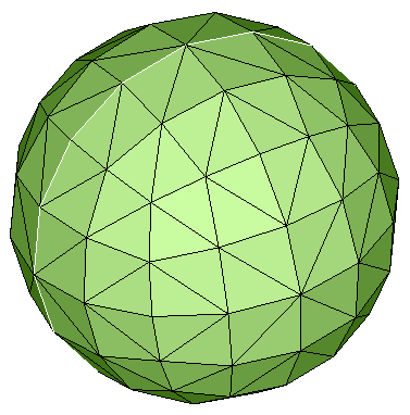

Example 1.TRI3
A sphere created with TRI3 as Element type and number of elements as 16.

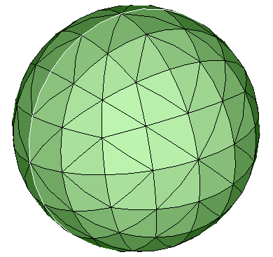

Example 2.TRI6
A sphere created with TRI6 as Element type and number of elements as 16.

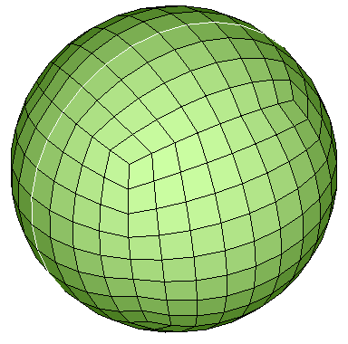

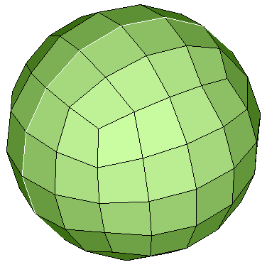

Example 3.Quad4
A sphere created with QUAD4 as Element type and number of elements as 16.

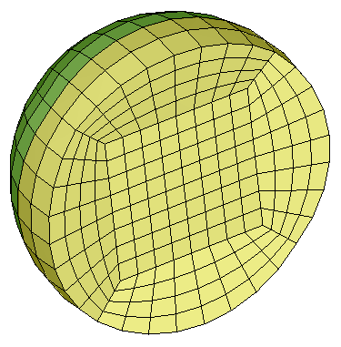

Example 4.HEX8
A sphere created with HEX8 as Element type and number of elements as 32.
